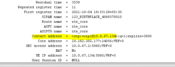

Our provider is forcing us to use a “contact header” like user (at) freesbc_ip_address during SIP registration.

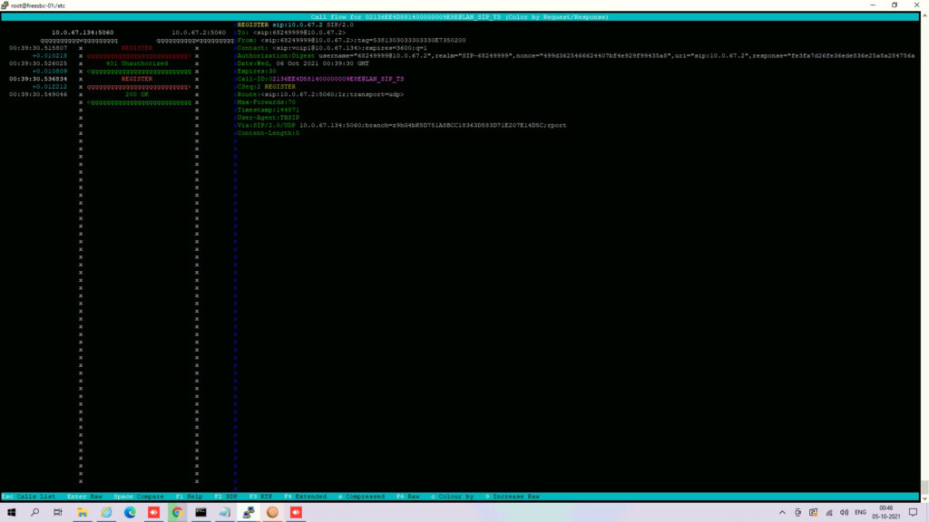

However, from FreeSBC, the contact header is going as interfacename (at) freesbc_ip_address.
Specifically, in our case, it is sending voip1 (at) 10.0.67.134, but should be 68249999 (at) 10.0.67.134.
On FreeSBC, the interface name cannot be an integer, so, we can’t even rename voip1 to 68249999.
I’m attaching the image we received from our SIP trunk provider as well as what we are seeing from our side.
Any help or ideas on overcoming this will be greatly appreciated. Thank you very much.
