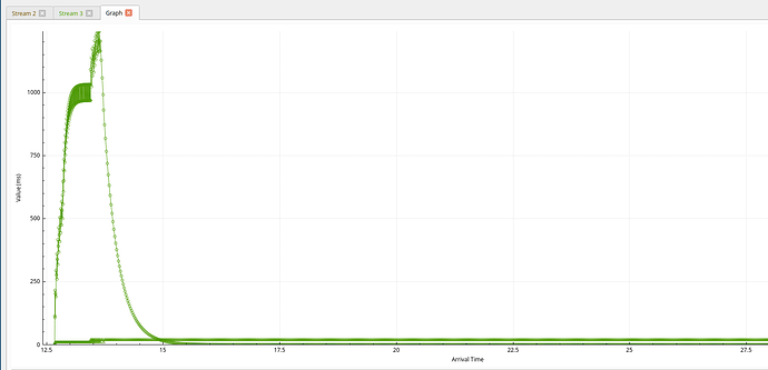

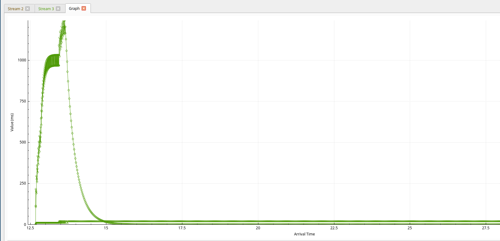

One of our customers is using a CaaS provider who has massive jitter (>1000ms) for a couple of seconds when the call is established.

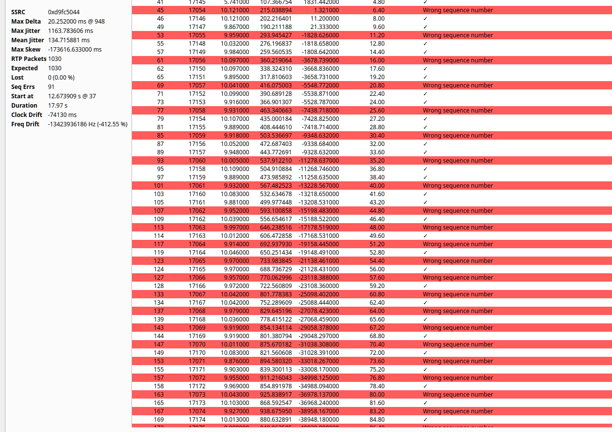

When ProSBC receives RTP packets with a high percentage of sequence errors, we have found that that it stops forwarding this media, leading to one-way speech. Even if the sequence errors normalize after some time, the one-way speech condition persists.
The provider feels the problem is not on their end (they are wrong, because a packet capture from their own infrastructure has the sequence errors [screenshots below]). While we can probably ‘fight’ it over, we also want to assist our customer.

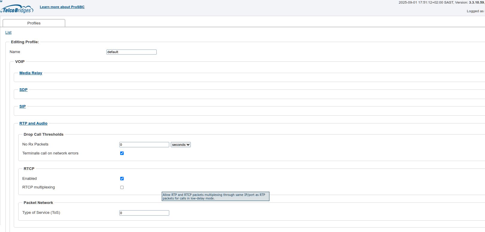

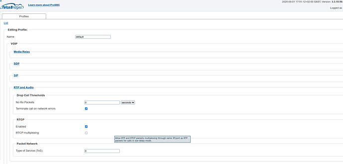

Modifying RTP and Audio Settings | ProSBC Documentation suggests that we should be able to modify the size of the Jitter buffer, but our menu does not look anything like this. Instead it is:
Looking at the data:
Max Jitter: 1130ms (The worst-case delay variation)
Mean (Average) Jitter: 134ms (The typical delay variation)
Delta: 20ms (The consistent time between packets being sent)
Packet Loss: 0%
It looks like there is a chronic network congestion along the path.
An average jitter of 134ms is about 6-7 times higher than what is acceptable. This can cause major audio problems. The massive spike here is the max jitter. It occurs when a network device (router, switch, firewall) is so overloaded that its queues fill up. Packets at the back of the queue are held for over a second before being forwarded, causing them to arrive drastically out of order and be flagged with “wrong sequence number.”

The settings that you mentioned applies for a TMG unit but not the ProSBC. We have updated the page to avoid confusion. By right, it doesn’t look like adjusting the jitter buffer is the cure to this issue.
