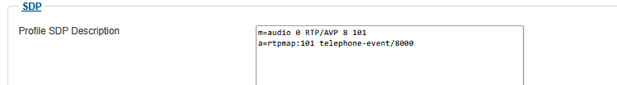

To avoid rejected calls I need to force SDP codecs offer to the Profile SDP Description.
I have the following profile SDP Description, if incoming call has more codecs on the offer they are being passed from incoming leg to outgoing leg.

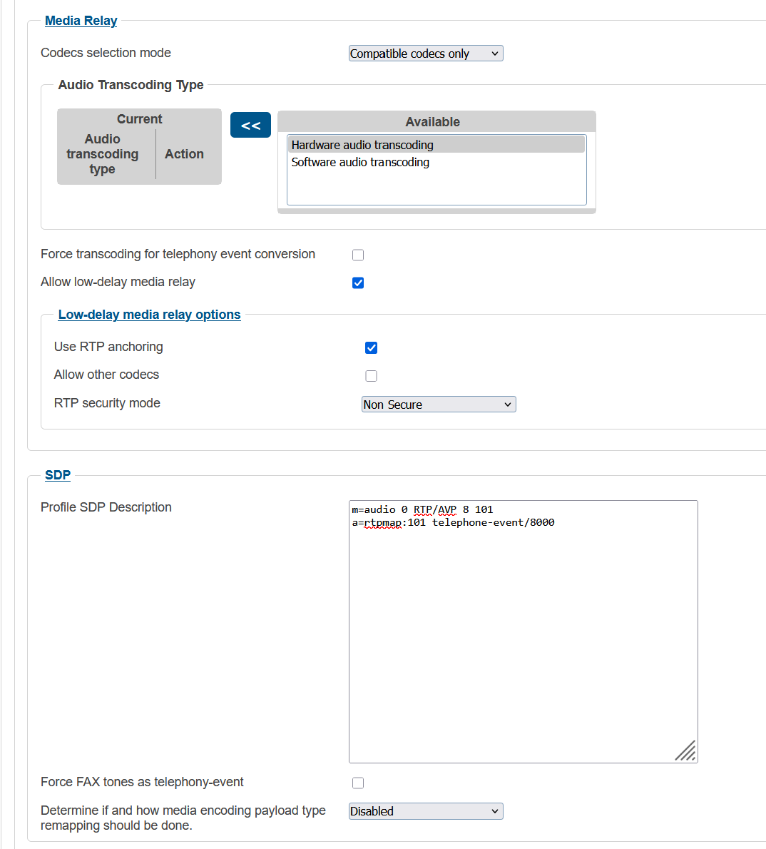

Try setting your profile to like this and then test.
  • Codecs selection mode: Compatible codecs only
  • Audio Transcoding Type: (empty — nothing in Current)
  • Allow low-delay media relay: enabled
  • Allow other codecs: unchecked
  • SDP Description: only the codecs you want (no CLEARMODE)

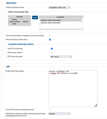

I already have my profile as you mention.
I made more tests and the issue happens when we have the CLEARMODE codec on the A-leg offer.
If the CLEARMODE isn’t present on the Aleg offer, ProSBC is filtering the codecs with SDP profile.
