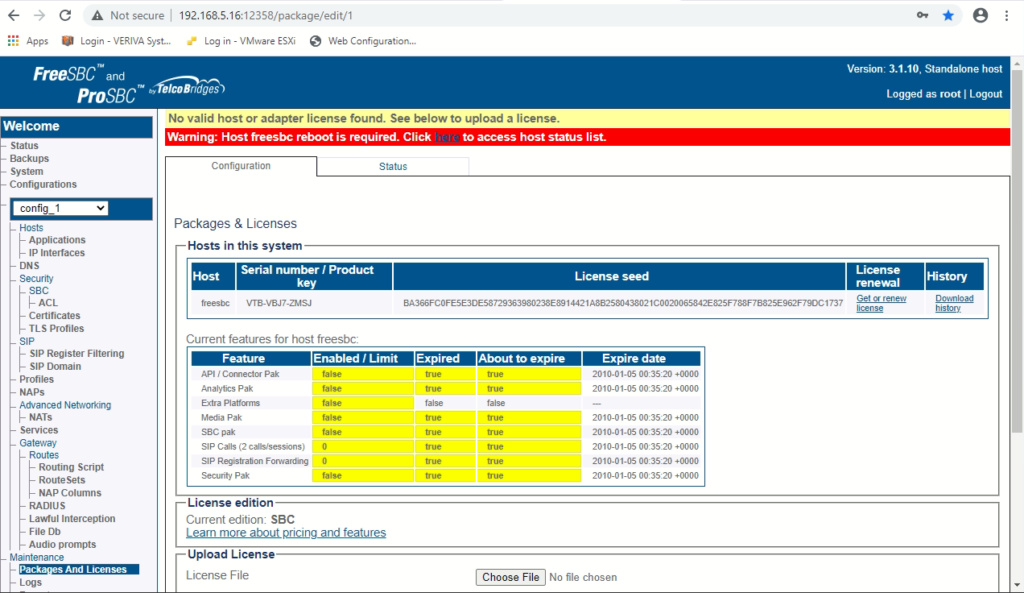

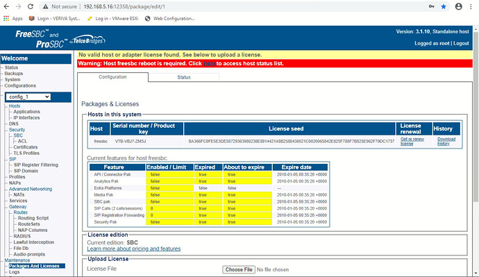

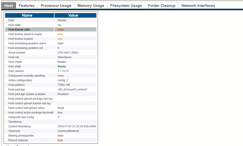

Hi FreeSBC, i am having this problem which my web portal showing the No valid host or adapter license found and Warning :Host freesbc reboot is required.
I have generate and upload license based on the guideline video on youtube, and also i have reboot the freesbc several times but the error still there. You guys can refer the error from image and host status on the url link given below.

I guess the license you entered in the FreeSBC is activated before. If you check the expiration date of the license you will see it is already expired.
