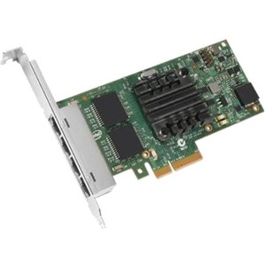

I am having a very difficult time trying to find a NIC to add to my Dell server (PCIe X 16 G2) with the specific chipset. For example I found a NIC with the 82540 chipset but not the 82540EM chipset. Can anyone recommend a compatible NIC I can use with a copper wire based network?
You can use 1Gbps network interfaces like the ones we use in our Dell Servers (TSBC-HW-SRV-MID) :
https://www.newegg.ca/Product/Product.aspx?Item=9SIAFVZ7252995&cm_re=Intel_Ethernet_Server_Adapter_I350-T4-_-33-106-247-_-Product
I also used the I340-T4 in one of my systems and this works as well.
I have searched for the 82540 Gigabit Ethernet Controller and seems they come in two modes: EM and EP. The only difference I found between the two is the EP one can run below 0 degrees Celsius and is probably more expensive. When they do not specify EM or EP, it should be the EM one.
Thanks! I found a very reasonably priced I340-T2 on Amazon!
