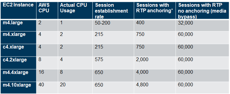

Hello
Can you tell me what is maximum number of sessions which I can handle with FreeSBC on AWS instalation?
I have 2 cases:
One is for 3000 sessions.
Second is for 13000 sessions.
Can I do it on FreeSBC AWS version?
Michal
Hi
You can go up to 60,000 sessions with AMI PRO and AMI Free editions. AWS Hosted edition can support up to 100 sessions. These are the maximum session that FreeSBC can support. You can check the table below for supported EC2 instances and FreeSBC limitations;
What you mean by * behind “Sessions with RTP anchoring*”?
Is it means that media (RTP) will be routed form network SIP_A to network SIP_B via FreeSBC on AWS and we are limited to G.711 codec?
RTP anchoring is where the RTP packets are “anchored” to the SBC (going through the SBC). We are not limited with G.711 codec on RTP Anchoring. You can use different codecs but cannot transcode between the codecs. Also, sessions with RTP Anchoring are limited by AWS bandwidth limitations.
