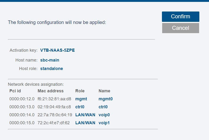

  4. Go through setup process until network devices roles
  5. Devs are visible, all marked as “SBC compatible”.
  6. Assign roles, no dedicated CPU, check, confirm
  7. Success and reboot for ISO image. Error message for KVM image.

The result the same: “Failed to configure network devices roles. Please contact support team.”

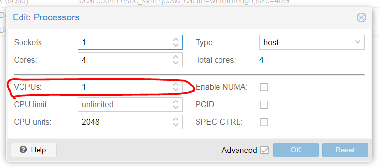

The trouble was incorrect Proxmox VM setup.
Occasionally, VCPUs=1 was set. Thanks to Serdar from support, we found and reproduces that if VCPUs=1 parameter is set to 1 - installiation fails that place. If it’s default value - everything runs ok for both ISO install and KVM image.
DHCP was finally used, but gues it does not matter.
