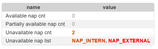

Hello,
I am encountering an issue (in the configuration of FreeSBC) with the NAPs.
Unfortunately, they remain disabled, which prevents communication tests. I also changed the number of allocated processors (as mentioned in a forum article), but nothing changed! They still remain disabled.
trace10

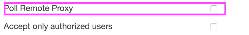

The most likely cause of the issue is something related to your network, or it could be that the SIP servers you’re trying to reach are not responding to SIP OPTIONS keepalive messages. If those servers are under your control, I recommend checking their behavior to confirm this.
Additionally, you might want to try disabling the “Poll Remote Proxy” flag and then attempt placing calls again to see if the behavior changes.

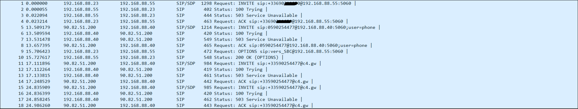

I am attaching the SIP capture as well as a report generated by the SBC:
report and logs :
Sip Capture :
thank you

From the SIP capture screenshot you shared, it seems the SBC isn’t routing the calls. Typically, it would return a 404 response when no matching routes are found — unless this behavior has been modified via SIP code remapping in the profile. Maybe there is also missing information on this screenshot.
Without direct access to the SBC, its configuration, and the full logs or pcap captures, it’s difficult to provide a definitive answer — we’d mostly be speculating. But let me know what you have access to, and I’ll do my best to help you troubleshoot.
