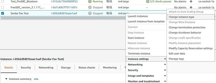

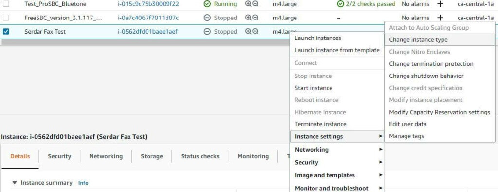

The instance must be stopped before changing the instance type. You need to right-click to instance select Instance settings and Change instance type.
You need to be careful when changing the instance. Some instances only support ENA (TB Trk#24792), so for the time being if you upgrade the instance to ENA supported instance SBC will not work and we are working on this to make it support accordingly.
