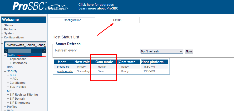

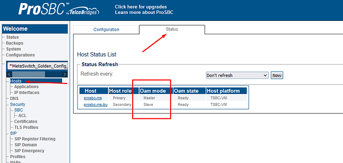

There are a couple of ways you can get that information, First of all you can go to the “Hosts ” page on your SBC and click ‘Status’.

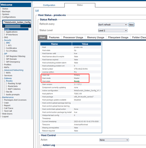

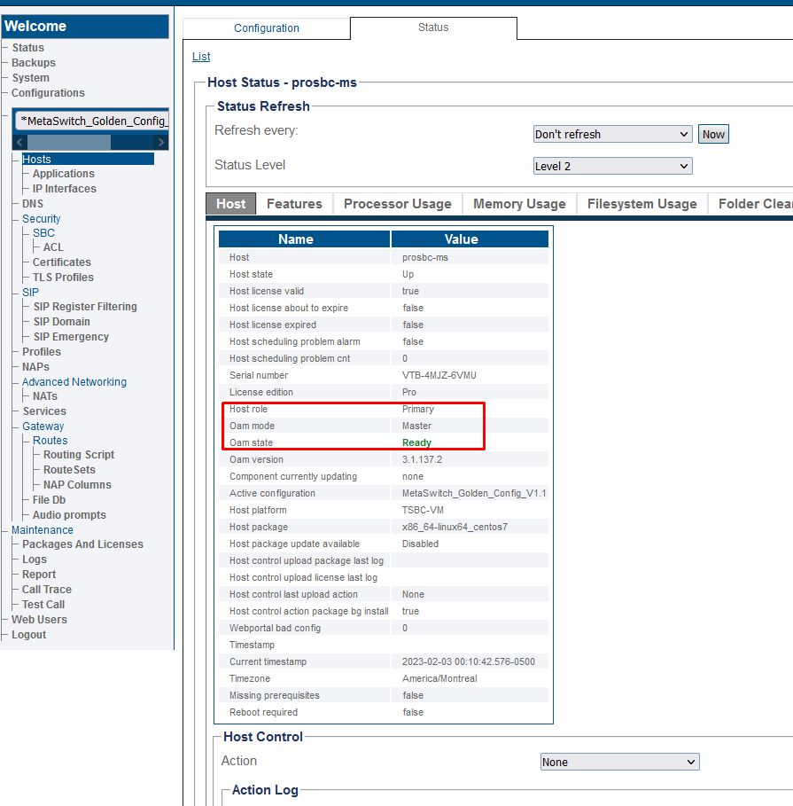

You also can go into one of the hosts individually and see the status:

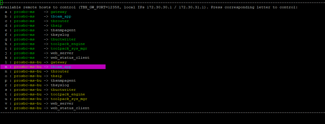

Another easy way is to go into the tbx_cli_tools_remote app by entering that command in an SSH Session, if you have your terminal emulator set to accept default colors you should see the applications color coded:
• Blue = Active/Active (normal only for tboam_app)
• Green = Active
• Yellow = Standby
• White = Passive

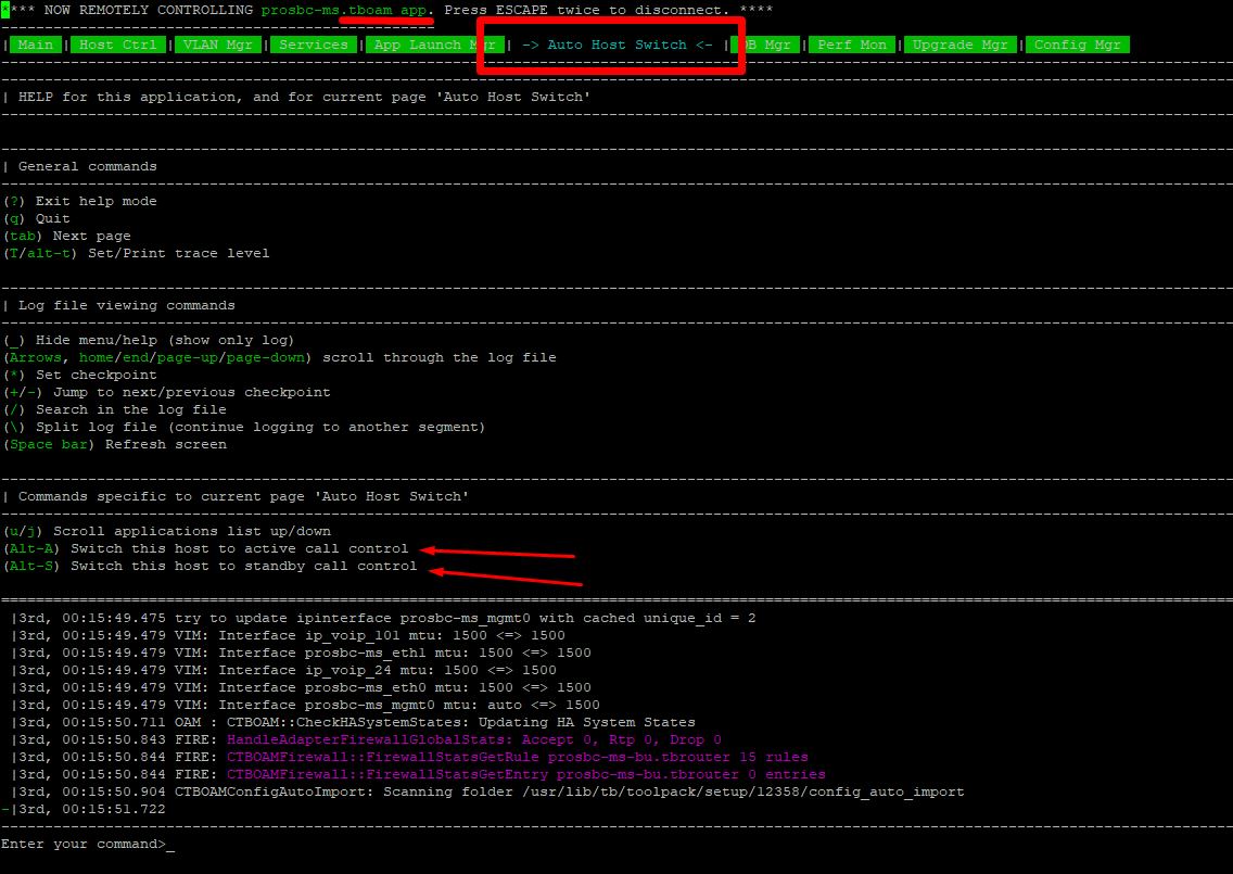

If you go into the tboam_app application and hit ‘tab’ to select the page ‘Auto Host Switch’ you can hit ‘?’ to show commands
There you can see commands (Alt-A and Alt-S, not Alt-a or Alt-s) to switch the host role.
