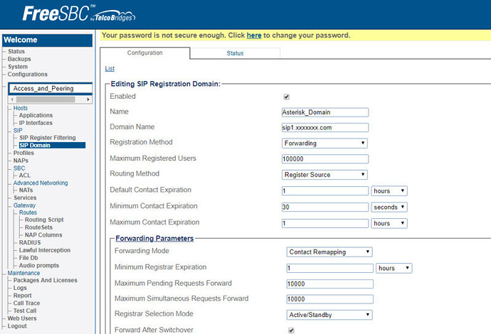

FreeSBC forwards incoming registration messages to the registrar but registrar returns an error. Please check the following points to solve this issue;
a. Check if SIP domain configured with correct registrar setting https://docs.telcobridges.com/tbwiki/Toolpack:Creating_a_SIP_Registrar_SBC_A
b. Check if Registrar NAP configured with a correct IP address https://docs.telcobridges.com/tbwiki/Toolpack:Allocating_a_SIP_Network_Access_Point_(NAP)_SBC_A
c. Check if your client configured with the correct username and password
d. Check the forwarding modes on FreeSBC, and select the correct one
Forwarding Modes
FreeSBC always modifies the contact URI in SIP register requests to remain on the path between SIP User Agents and registrars. FreeSBC supports two different SIP registration forwarding modes (i.e. “Contact Remapping” or “Contact Passthrough”).
• The “Contact Passthrough” forwarding mode makes contact username portion of the contact URI in SIP register requests to pass through unchanged.
• The “Contact Remapping” forwarding mode modifies contact username portion of the contact URI in SIP register requests and makes it unique.
To check Forwarding modes; Go to SIP → SIP Domains → Select the SIP Domain Name → Forwarding Parameters
