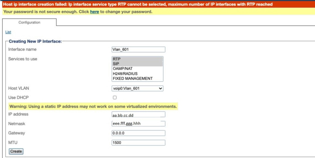

we have an issue when adding a new RTP interface…below is the screen capture… currently we already create 15 IP interfaces for RTP service… and having this error when we want to create the next one…
is there any solution to this?

At the moment, you could assume the max number of IP interfaces is at 16 as from the alarm avobe.
