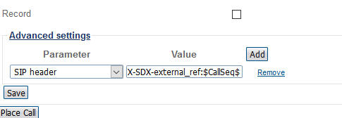

I would like to add two new fields to the header, I believe it is in the scripts, but I have no idea which script to configure and which parameter to add … in test call> advanced settings> Paremeter, I choose SIP header, I add a value, but the SBC does not send the defined parameter, how to use the SIP header parameter in the test call? thanks.

In the Test Call Screen Advanced parameters you will Parameter Drop-Down menu. You need to select SIP Header and need to add the additional header on Value.
I understand, you can take a look at the print below, the Value field is correct? it is necessary to use a specific language, as the capture cannot find the custom header, only the other generic headers.
You don’t need to use any special languagu on the parameter. If you want to send X-Custome-Header: Telcobridges in the INVITE message just write X-Custom-Header:Telcobridges on the parameter.

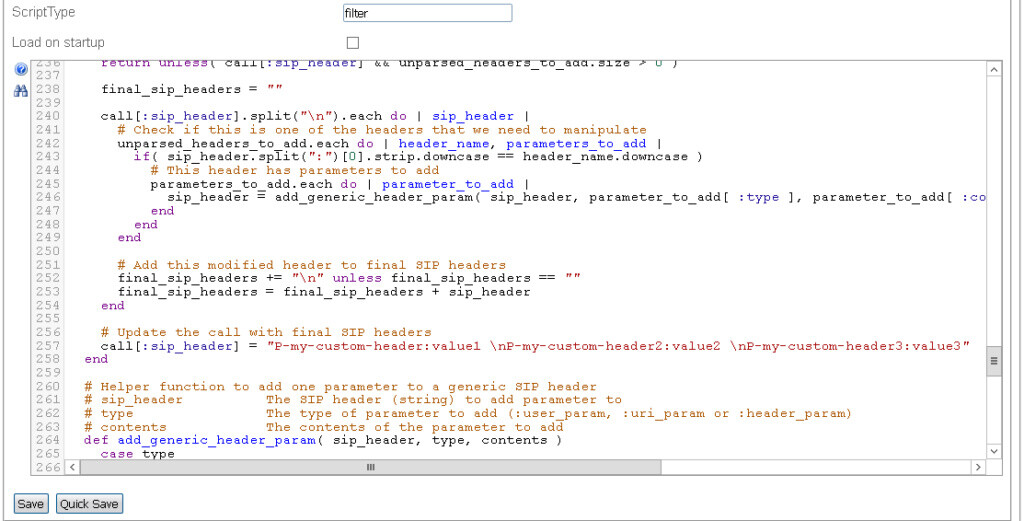

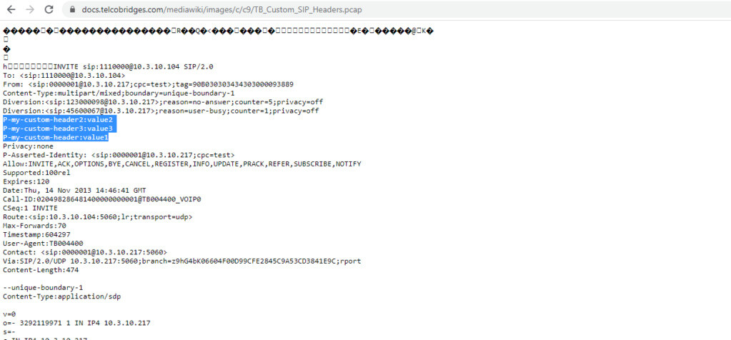

Thanks for the reply friend, I definitely can’t do these settings, the sip_header_params.rb script already exists, it’s in “Filter Scripts” I’ve already added “require ‘sip_header_params’ unless defined? (SipHeaderParams)” in the simple_routing_sbc.rb script and the script simple_routing.rb, I already added the custom parameters in the script sip_header_params.rb (print attachment) but without success, I would like the call to exit with the parameters of the link https://docs.telcobridges.com/mediawiki/images/c/c9/TB_Custom_SIP_Headers .pcap used as an example.
I would like the calls to go out this way.
