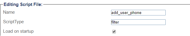

In some cases far ends wants to see user=phone on URI and headers. You can simply add this to your URI and headers with following;
  1. Create a new script named add_user_phone
    Adding user=phone to URI and headers Add_us10
  2. Copy following script part and Save

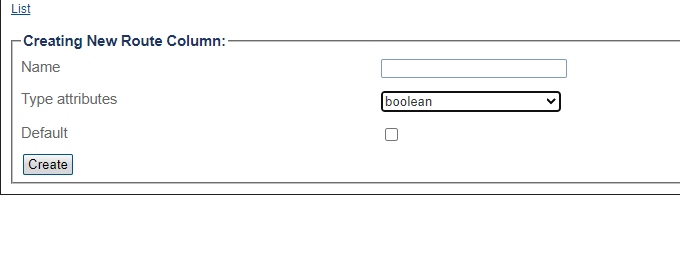

3. Optionnally, you can create a new route column named “add_sip_header_params”, type boolean.
This route column (attribute) will determine, per route, if the defined SIP headers must be added or not.
(custom route column can be created in the “Routes” section of the web portal under “Create New Route Column”)
It is self explanatory. The above script also can cater if you want to do this just per route, using point 3, create a new route column. You could do this at static route, “create new route column,
